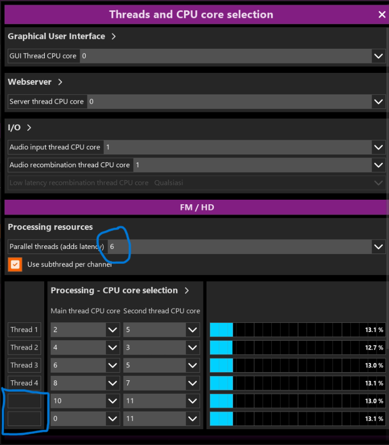

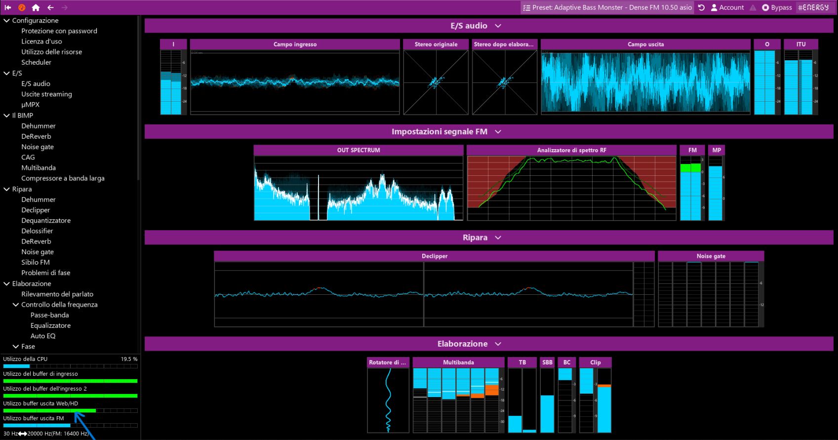

I went from 9.92 to 10.50 (on 9.92 it doesn't do it, same preset, same settings), I have an over buffer problem on out HD (see screen shoot), I solved it using only MME, but I don't like win drivers
I also noticed an error on the gui in the threads & CPU section (see screen shoot)

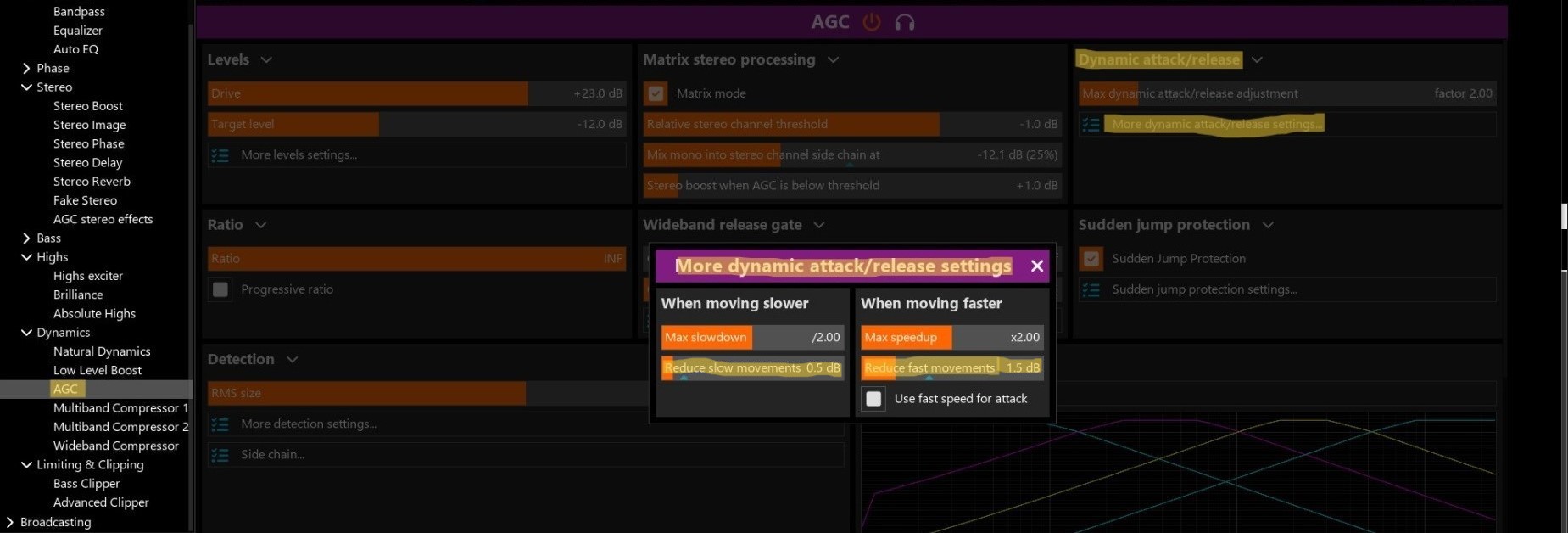

It would be useful, given the countless submenus, when multiple changes occur in the setting of a preset, that each change was visible to the eye....
For example, if I change in agc/dynamic attack-release/more dynamic attack-release setting/reduce fast movments & reduce slow movments , the entire logical tree structure of the names mentioned above (in the agc page in this case) would be highlighted in another color (yellow text).
I have a request for you, I think it's important for many users now that the streaming section is complete, add SHOUTCAST 2 server.
Best Regards
Luca

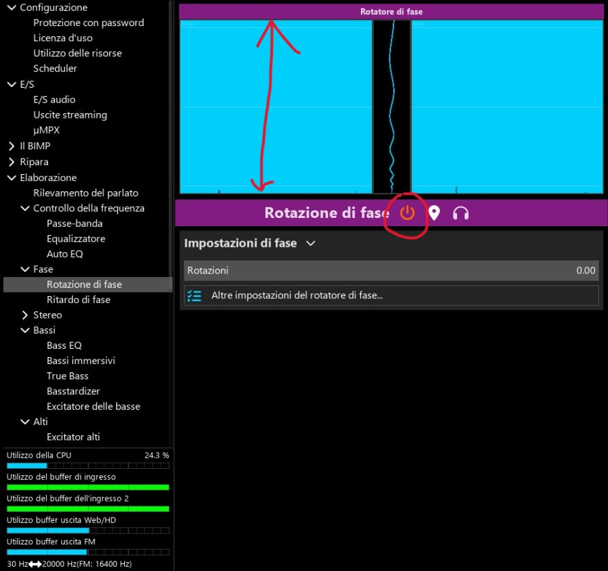

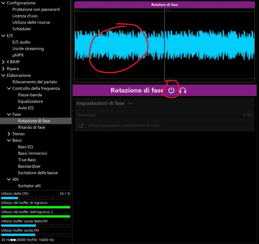

another display bug in phase rotator, when you activate the filter, very high waveform.

There are a few known issues with version 10.50:
  • Some GUI elements have no names. I think the thing that NRG reported is an example of this. This has been fixed on our end.
  • Multi-instance web interface doesn't work well. Instance 1 is fine, but for subsequent instances, the preset list isn't properly filled. For both multi-instance builds, we've reverted the downloads on the site to 10.41; we're working on a fix, expected by the end of this week.
  • libxkbcommon dependency in the Linux build. There has been a version of our SD card image that came without libxkbcommon installed. Probably fixed, I'll run a test build tonight.
The multi-instance web interface fix is quite risky so this will require a lot of testing, both on our end and hopefully also from beta testers.
@NRG: I don't see the issue with phases here. Can you send me your settings? Hopefully it will reproduce if I have the same settings here.

Highlighting the whole tree structure: Not sure, is that a good idea? You triggered a discussion on our Discord server by the way, but the question is how to do this without making everything look really messy.
it's not a criticism of the structure or that there are too many parameters, on the contrary it's right that we can experiment as much as possible, the problem is that if you vary more than one parameter before finding it it takes a while, I think that highlighting the text of the structure where the change occurred is useful to quickly find the modified parameter....then you choose what seems most appropriate to you.....it's just an idea.
ps. where can I see this discussion on discord?
