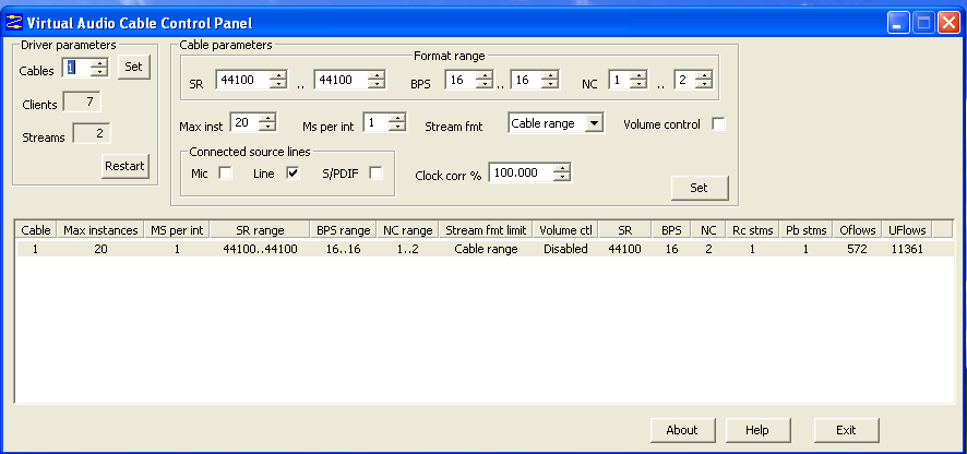

first of all i feel the need to thank you again for you time and your help
i test to shoutcast 1.9.8 same thing again... i have change edcast and i use butt cast nothing happens again... i thing the problem probably is at vac or st :( because sound to my console is crystall clear )
I forgot to tell you that i am on windows xp
And i have setup my radio like this
Jazler >> soundcard output >>> console input then from console output >>>> soundcard input >>>> stereo tool >>>> vac >>>>>> edcast >>> to shoutcast server
i dont know if that is ok i am amatur...
i attach photo my vac settings
That's ok but i notice that you use older VAC, newer version may also help with priority settings.
If you want, i can come with TW to check what's wrong.
