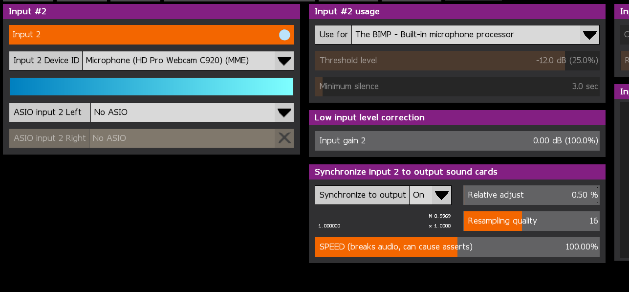

By the way, this is next:
Works for the BIMP now, not yet for adding/backup, but that should be more or less the same.

O, is it just same sync as on input1?

Similar settings, but it syncs separately. And you can configure it differently if you want. So, if the 2 input sound cards have different clocks, they will both sync to the main output, which is exactly what you would want.
Ah, this reminds me of the 80's back when I used a TBC (Time Base Corrector) to improve video editing. Smart idea use for audio!
