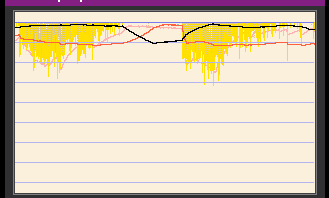

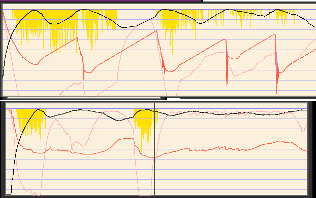

After driving through Germany for (in total) about 20 hours, I got some new BS412 ideas and I think that I've improved the BS412 limiter in Stereo Tool.
Many stations in Germany clearly had issues with BS412 (a new song starts with a lot of bass, or one that's just very dense, and after 5 seconds the level drops by multiple dB's, for example).
This image shows the old (on top) and new (bottom) BS412 limiter behavior on slightly too loud audio, with all other protections (compressors/limiters) disabled. As you can see the one at the bottom looks much more stable. The main changes are that it goes down quicker, due to which it doesn't have to go down as far, which makes it actually less audible. Also, it goes up much slower if the predicted output level is close to the target, or if there's very little headroom available. In the (rare) case that the input level is way too low it actually goes up faster. As a result, the ouput sounds more constant and it's slightly louder as well.
On top of this I've added an extra compressor that "moves with" the BS412 behavior, ie it compresses less if BS412 is already reducing the level (which basically makes it back off on denser/more bassy sounds). You can turn this on to make quiet sections a bit louder, and also generate a more "radio-ish" sound.
I have added a "Legacy mode" switch in the BS412 page, it's OFF by default because I don't think there's any good reason to use the legacy mode instead of the new one. I'm not 100% sure of that though.
Both images made with several dB's more drive into BS412 than what we would normally advise, to get more extreme results, and without using the new compressor.

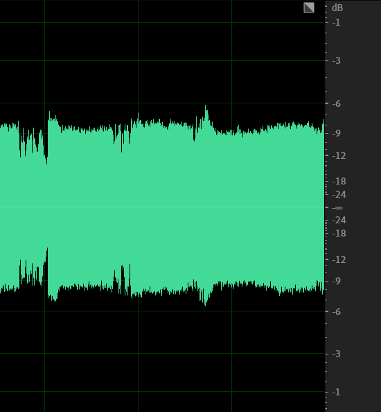

I think now rather less..... Here is an example from a large radio station in Germany. They definitely use Orban products. The result, which is broadcasted, looks like this. Seems to be more a problem of BS412, and not coming from the product.

BETA006 is posted. I think I'm done with BS412 for now, it's really tons better than it was. It really wasn't bad before, compared to many other processors on the market, but the improvement still seems to be really huge.
For those of you who know how to read the BS412 graph: Here are before (9.81) vs after (9.82 BETA006) images, in both cases with extreme settings (way too loud input, all other protections (post compressors, limiters) disabled. Audio is a set of fragments of very different songs.
As you can see, the new behavior is FAR more consistent, despite the fact that on silence (not visible here) the level actually goes up faster than before. It's also on average 0.3 dB louder.
With sane settings the graph looks like this:
