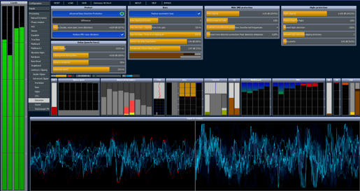

I found an old recording from end 90's from a non stop program, which in those days were very clipped.
So I decided, to run it through StereoTool as a test. And I'm stunning about the results, especially because I had a short talk with Mathijs on the IBC about heavy clipping.
So I was guilty in the first degree back than :mrgreen:
Processing was a Aphex Compellor > Orban PC card > Stream
See for your yourself in the pic.

Yet, Your output still looks bad. Don't avoid ABDP!

Yep, you are right, earlier today I adjusted bass levels in multiband 2, seems I pushed ST over the limit.
Also the recording is totally messed up, if it's broke, it's broke. So I deleted it. Better for my ears and speakers.
ABDP is on, but when over clipped it also has it's boundary's.

Nope.. you are using wrong settings.
Set 150 > 400Hz. up to clip below -1.94.

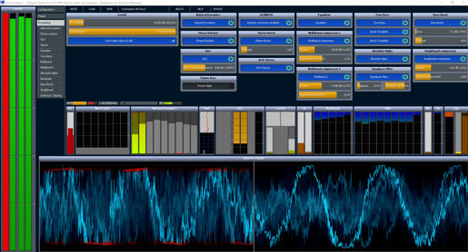

Yes it makes a big difference, another lesson learned, thanks Bojcha.
This is a new screenshot, music track was Michael Jackson - Stranger In Moscow.
