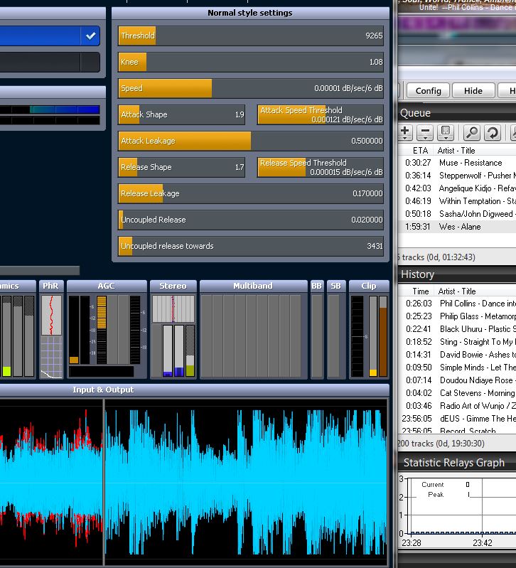

Hi Hans!
New singleband looks(hears) useful, definitely not with the default setting.
Gave it a try, even without multiband, can be fixed rather straight!
