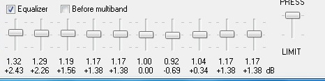

I like this set equalizer...

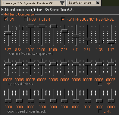

Posts: 475
Basically, the update resolves almost all of the issue with the loud vocals getting softened. Fixing it was actually kind of simple when you think about it...
If you want to have the majority of the change, load the preset and then lower the multiband down speed for 880 Hz and "1.8K" (actually, 1760 Hz) all the way to 0. This keeps the volume up for those two bands as far as is allowed, and only has clipping when it is needed.
LOL
:arrow:
viewtopic.php?f=10&t=4093
 Post subject: Re: Purity Control
PostPosted: Fri Apr 06, 2012 5:54 am
Posts: 885
I'm not sure that's a good thing to do if you've got the slider towards "Limit", but I haven't checked into that, so it might be ok. What setting to 0 does if you're set to "Compress" makes it as close to limiting as you can get, I think. I'm a bit concerned that it might not handle something where those bands are too loud, which would be addressed if the slider was on "Limit", because that would say that the volume can not go any higher than that point.
Basically, I'm finding that a lot of settings that I thought other people had researched and "should be fine for me too", really aren't all that I thought they were... First it was AGC, now multiband...
PostPosted: Fri Apr 06, 2012 6:22 am
Posts: 475
I had the same idea ( :arrow: that preset uses 100 % compress characteristic in MB).
It is true that all my older presets (BASE etc.) use 100 % limit characteristic, but not that Dynamic Empire V2 preset !
Though I still restrict percussion sounds (with the extra benefit of a HQ de-essing already before the LN De-esser) this preset sounds much better with (inexpensive) headphones than my BASE V1/V2 presets.
