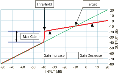

Output Level at Target add a control to set a window in dB. This window makes the AGC level ignore changes in this respect to the Target Level Ouput, with this effect is diminished enough that unnecessarily increase or decrease the gain, the remainder being absorbed by the rest of the process chain.
Another idea is to use the AGC according to the diagram attached image.
Further details on the following link http://www.rane.com/note155.html#apm1_4
This causes the AGC output level after the target output level function as a compressor.
These are ideas to add ... ;)
