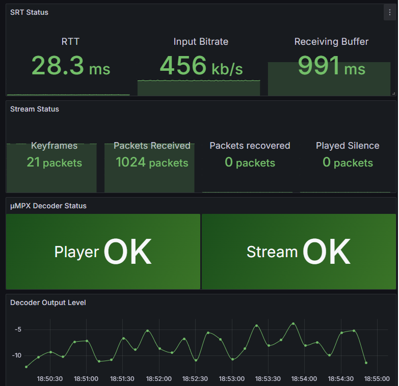

You think about µMPX over TCP, why not use SRT instead, as already requested here:
https://forums.stereotool.com/viewtopic ... 16&t=31044
That'll solve all sorts of scenarios where you can't push µMPX to a fixed IP address or where you have more than x transmitters using the same µMPX feed.
Given the "success stories" I've heard about SRT it might as well fix the Starlink problems.

And SRT would provide compability to the 2wcom MPX Decoders.
Does SRT give us everything that TCP gives us? Including going through routers, dynamic IP addresses at the receiver side, etc? If so, then this would be the much better solution indeed.
PostPosted: Wed Sep 25, 2024 6:51 pm
Posts: 30
Yes, yes and yes. In case you have a dynamic IP at the receiver site SRT will establish the connection for the receiver site. SRT is UDP based but all the features you expect from TCP and much slimmer. Packageloss of ~5%? No problem. I use StereoTool with µMPX over SRT using local srt-live-transmit command line tools to pipe UDP into SRT and vice versa. Runs like charme. And you have nice stats about the connection state on both sides as for retransmitted / Lost packages. Great for monitoring, like here in Grafana
