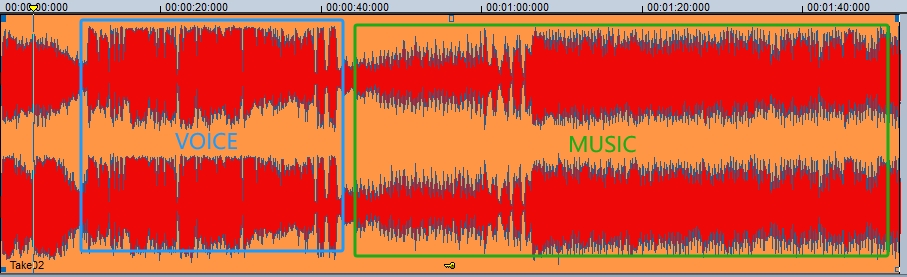

I'm setting up a preset for the TV show.
Referring to the sound of global TV broadcasts, I prefer the sound of Hong Kong TVB. His speech is very loud, pressing the peak level, and his music is very flat, not very loud.
But when I was tuning the Stereo tool, if the voice was loud, the music got louder :P :P

I've tried this too, but it requires more bus and more audio channel interfaces.
As the end processing of stereo sound, I think the stereo tool will have a better data setting, and I haven't adjusted it well yet. :D
