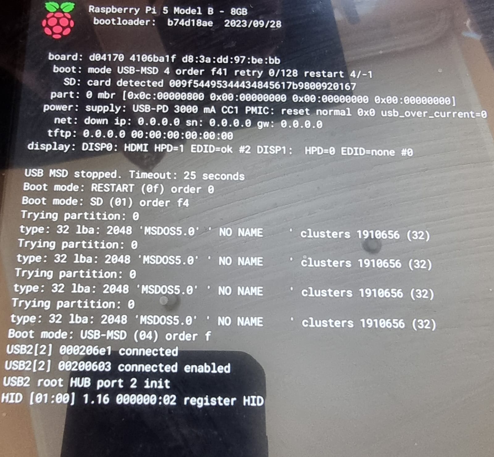

I bought a raspberry pi5, when will there be updates for the new machine? Thank you
this image does not want to work on raspberry pi 5

My Pi 5 finally arrived today, so I can finally test it myself. I haven't had time to do any tests today; hopefully tomorrow. What I did for this specific image is update the existing image to the latest Raspbian, which should support the i5. But maybe I've missed some steps.

I have it working on my end. Apparently you have to manually update the bootloader; if you don't Bookworm will start on a Pi 4 but not on a Pi 5. It appears that it might not run at all anymore on a Pi 3, which would be annoying if true (haven't tested it yet, but if true I would need to keep 2 versions).
I also had to make a small change to the binaries themselves (they ran but with a lot of error messages); I'll run a fresh beta build tonight and, if nothing goes wrong, upload a new image tomorrow morning.
