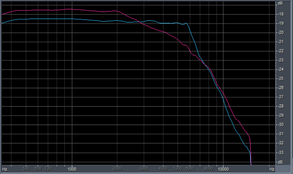

PostPosted: Fri Mar 19, 2021 12:44 pm
Posts: 4240
hmm.. small hole around 2.8-3.1kHz, depend on new slider - steep cut
This is not same as beta001
PostPosted: Fri Mar 19, 2021 1:09 pm
Hm, I see about 0.5 dB of drop between 2.2 and 3.1, but that's probably not what you mean? I don't see anthing special around 2.8-3.1, and based on what the code does, I can't really explain that either. What are your settings?
BETA001 was indeed different, that was from before I started looking at the audio without Leif's Gap Protection mode (it had much deeper drops for bass and mids, among others). BETA002 should be much better.

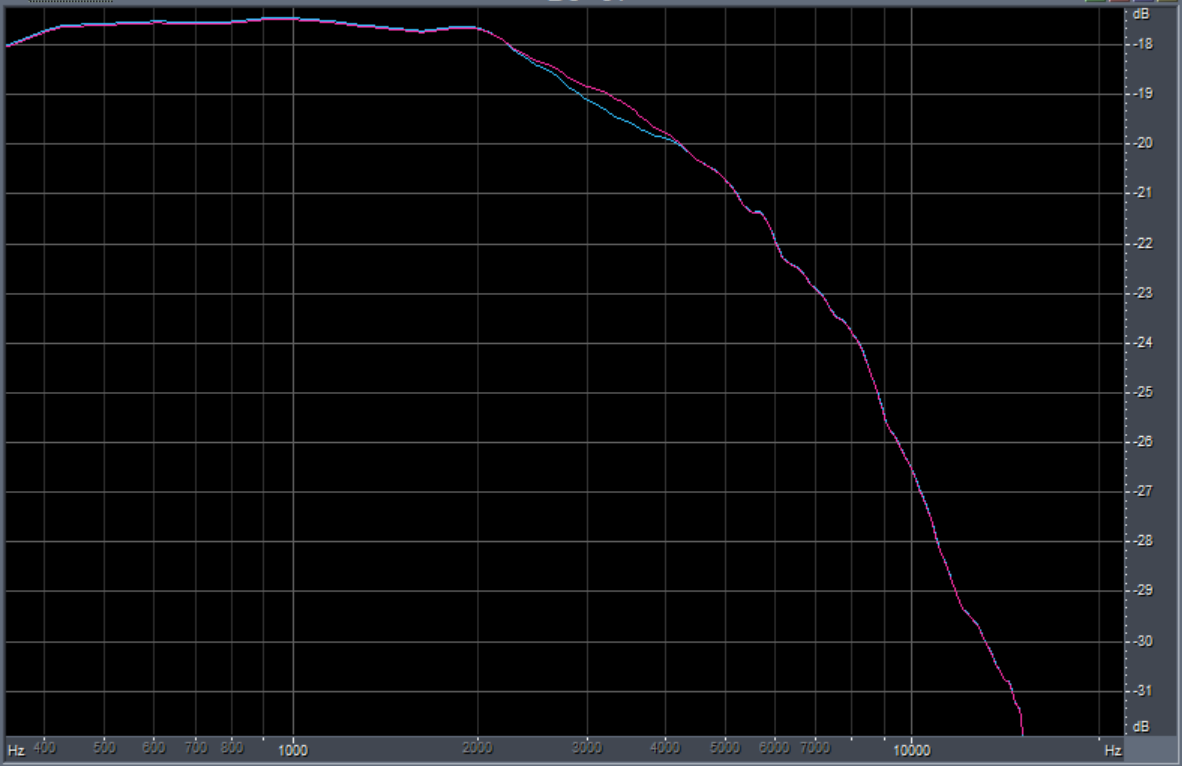

PostPosted: Fri Mar 19, 2021 1:26 pm
Posts: 4240
Yea something like that 2-3kHz.
now to smooth it out i kinda set highs/rest to 450% and those two sliders to 35% and 2000Hz. Not sure..
PostPosted: Fri Mar 19, 2021 2:53 pm
I just discovered that I broke Legacy mode in the previous beta's, so the difference was actually bigger than it should have been. I just fixed it but the difference is still huge. Legacy vs New mode, white noise, default settings:
PostPosted: Fri Mar 19, 2021 3:04 pm
Posts: 4240
And what about this "improved protection" ? That thing also do something..
PostPosted: Fri Mar 19, 2021 4:51 pm
I can't get the line completely smooth but I think this looks better:
PostPosted: Fri Mar 19, 2021 6:10 pm
Posts: 4240
ok is that cooledit?
and what exactly is that signal, i want to compere something with something :D
PostPosted: Fri Mar 19, 2021 7:54 pm
Audition, but that's basically the same thing.
This is white noise played through Stereo Tool, 50 us pre-emphasis, with the clipper drive set to +12 dB, demodulated output. It looks roughly the same for composite and non-composite clipping (this image used composite clipping). In Audition, block size 256 samples (@ 44100 kHz), spectrum of 10 seconds of audio (since testing is really slow in debug mode, it takes a while to generate enough data - the graph might get slightly smoother with longer recordings).
