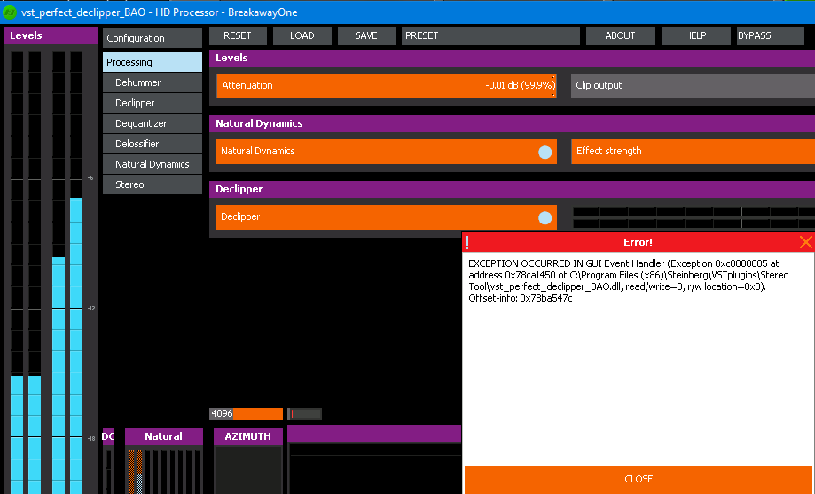

I found 2 bugs in the parameter handling of the Declipper plugin specifically, which may have caused crashes.
PostPosted: Wed Jul 08, 2020 7:50 pm
Posts: 1055
Nice. No crashes yet, but using CTRL when sliding the attenuation still causes this bug. (32 bit VST in BAOne)
Should I bother posting this particular non-critical issue anymore? Or just wait for the new GUI beta?
PostPosted: Wed Jul 08, 2020 8:18 pm
Posts: 11516
No, stuff like this one is important. Please keep reporting it. You're getting an error message - and if that happens nothing breaks, but it could also cause undefined behavior. The new GUI is progressing but it's not ready yet, so for now this needs to be fixed.
PostPosted: Thu Jul 09, 2020 7:19 pm
Posts: 11516
Found it. There was a check if you're in VMware, but the VMware setting was disabled in this plugin. That caused it to crash. I've added that setting back, so it should be ok in the next build.
