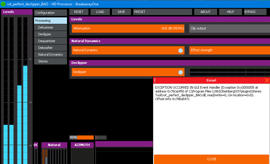

I had another crash happen in the latest Declipper VST beta (32 bit) from the 1.50 thread, crashing the host. It occurred when I was turning up the number of processor threads shortly after refreshing the window by minimizing and restoring (this was my solution to the issue of it not filling out the breakaway one host window upon launch). I didn't catch the error in time, however. And I've been unable to reproduce the crash.

PostPosted: Wed Jul 08, 2020 7:50 pm
Posts: 1004
Nice. No crashes yet, but using CTRL when sliding the attenuation still causes this bug. (32 bit VST in BAOne)
Should I bother posting this particular non-critical issue anymore? Or just wait for the new GUI beta?
PostPosted: Wed Jul 08, 2020 8:18 pm
No, stuff like this one is important. Please keep reporting it. You're getting an error message - and if that happens nothing breaks, but it could also cause undefined behavior. The new GUI is progressing but it's not ready yet, so for now this needs to be fixed.
PostPosted: Thu Jul 09, 2020 7:19 pm
Found it. There was a check if you're in VMware, but the VMware setting was disabled in this plugin. That caused it to crash. I've added that setting back, so it should be ok in the next build.
