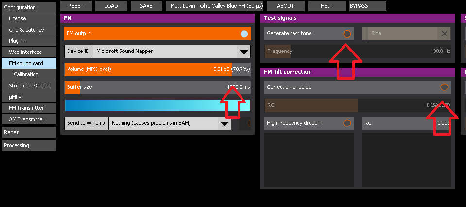

Hi, if you are using the VST plugin, make sure that you're using the "FM sound card output" in Stereo Tool. You can't output the signal through mAirlist, for several reasons.
See the arrows here. Can you find this screen?

Thanks for the info. But the plugin looks different on me.
unfortunately I cannot upload a picture
PostPosted: Mon Jun 22, 2020 5:15 pm
Posts: 11515
How does it look different? Older versions had a different default color scheme but that shoudln't matter. Beside that I have no idea how it can look different (you could have more settings, but these settings should still be there).
Do you get an error when you try to upload a picture? It should just work via "add file" at the bottom of this page when you're typing a reply.
