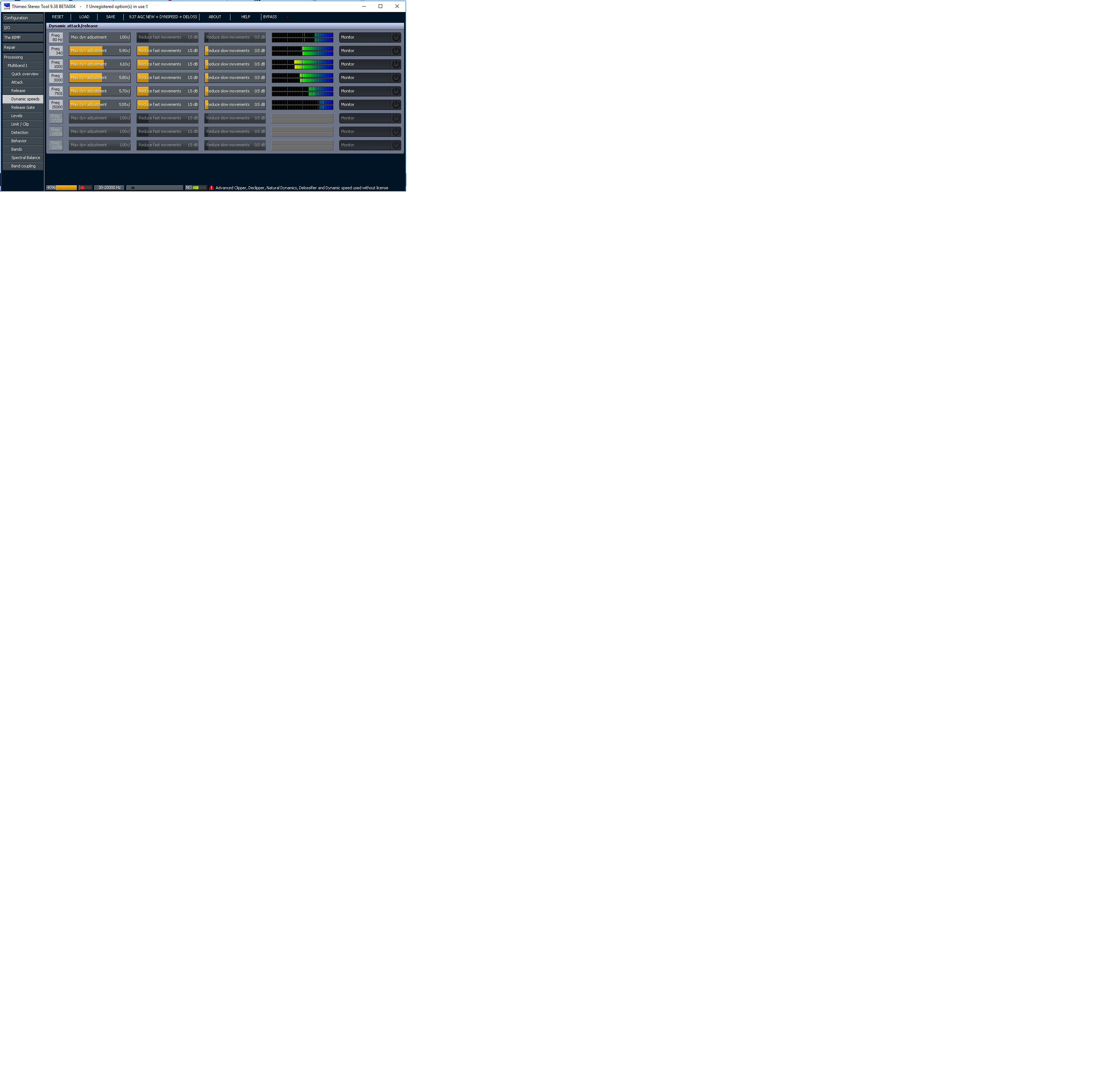

incorrect version or download "64" "32", in beta 8 and 10.
"Stereo_tool_standalone_installer_64_BETA936-010.exe"
installing them he writes ..ver 9.36-xx
Edit:
Beta 04 ...ok.
"stereo_tool_standalone_installer_64_BETA938-004"
