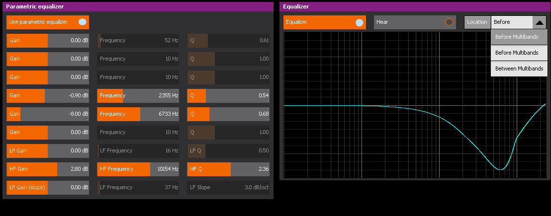

Hoi Hans,
The dropdown menu to select the equalizer location in the processing chain has two 'Before Multibands' options, but no 'After Multibands' option.
Kind regards,
Gabriel
P.S. Don't forget about saving the Stereo Goniometer time base ;)
File comment: Screenshot

I was going to post a topic about this myself after I just noticed it. I think it's that one of them may be mislabeled.
Bojcha, hvz, if either of you see this.... which of the two is properly labeled, and which is actually after? Having post-multiband EQ would be preferable in a preset I'm working on.
This is something that I was also unclear on and the documentation doesn't cover it.
And I too would like to have the ability to place it just before the SB/BC/AC. Otherwise I need to disable those in one instance, insert an EQ plugin in the chain, then another instance to manage final peaks. I realize the multibands can be configured to color sound much like an EQ, but I'm still pretty terrible at configuring those.

SC PEQ does not change 'sound', it only change on what/adjusted freq will compressor react more or less.
For example i like to remove bass from WB compressor before clipper, since there is anyway bass clipper after that and in same time compressor will do the job much more consistent no matter how much bass is comming in it. Similar can be used for highs so to make compressor 'ignore' loud highs bursts like "S", "C" and similar sounds. It's too bad that we cannot hear (monitor) adjusted freq by that SC PEQ.. but eeh, probably another uninportant thing to add.
And yes, i already asked about this 2x "before MB" and if i remember it has something with older presets comatibility. Cant remember since i always use it before MB.
However there IS some broken presets in this very moment.
