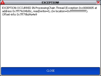

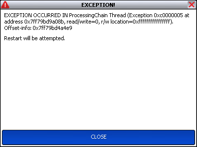

Posts: 27
Tested the 64bit version I got 2 pieces of error messages. The first one visible immediately after program start and the second one about half seconds later. Some seconds later the program restarts itself.

Posts: 11516
Ok, I think I fixed the 2 issues that arche mentioned. I cannot reproduce them here (they only occur on certain CPU's). Rebuild running now.
