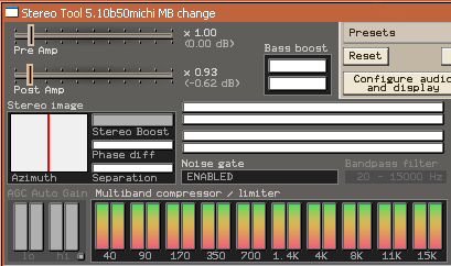

Just to be certain that we're talking about the same versions...
The best protection against that kind of mistakes would be the individual naming of every Beta build inside the window title bar.
Every user can do it with a simple editor (like I do -> search for "5.02" and edit the window title), but it would be easier if Hans would do it for us.
Here you see Beta50 Michi build with changed Multiband frequencies (-> search for "16K" to find the frequencies and edit these):
File comment: This the special Beta50 Michi build with changed Multiband high frequencies

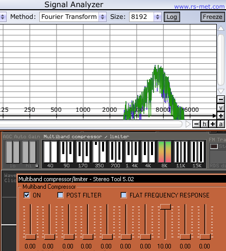

Hi HvZ, I'm using Stereotool for two years, and test also the new beta's. And for the first time, I like the multiband very much with the Michi95's settings. It's increase the presence of the sound.
Would you continue to use these settings?
Of course this is a question only Hans as author can answer.
Obvious there is already so much complexity (and complication) for the changed loudness settings and options to finish this Beta project and get to the final 5.10 release, that an extra (detailed) discussion about Multiband frequencies would make this a never ending story.
So let finish Hans first the most important things and then we have something for the future.
I don't think that my idea with 1.4K-4K-8K-15K is already the best of all possible solutions (I took it out of the blue).
Especially I think that some bands have to be very narrow (8K for sure).
But in this special Beta 50 Michi build 8K is very broad.
So I am really looking forward to a detailed Multiband reform discussion for a Stereo Tool V6 beta in the future, but not now.
Best solution would be if you can change frequencies (and bandwith ?) inside .STS !
