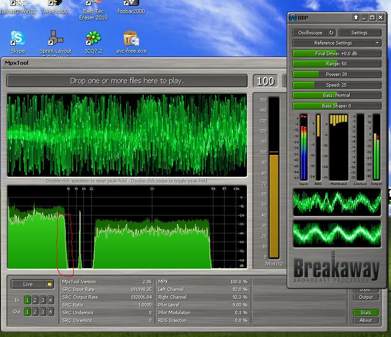

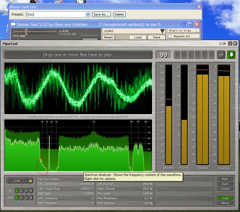

For the much yes , not that much but it is noticeable .
So must be corrected .
I say that beta25 is enough of options for bas, highs , loudness... ect
So why don`t You correct that version without add any options and that`s it :)
I really mean that no need other options , these in beta25 are good and do their job correct exept that highs-bass that i explain before , but i`m right right? ... this is from HARD LIMIT ?
And sorry but in Latest version this problem is there ...........SEE
And highs-bass thing is more noticeable with default settings !!
As you can see the filter of 15Khz is not that strong in BBP , but in ST is very strong (no start and finish frequency)
I`m a friend of StereoTool so thatswhy i want to be the best because this BBP you see at first picture is very hard CPU load program , but ST is doing the same with MUCH MUCH lower CPU load
BBP : 70% CPU
ST: 25-29% CPU now i use VST ( foobar with DSP host to winamp ans ST is less than 25% - 17-20% )
Athlon II X2 240e (2.8 GHz) ............... WOW isn`t it ?
File comment: THIS IS WITH BREAKAWAY BROADCAST PROCESSOR
File comment: THIS IS STEREOTOOL 5.02 BETA51

All ok here:
Beta51 - Loudness 4.00x comp.limiter to 106.5 ... // rate - 192kHz
What Sample rate you use ? - Same happens here if I use 44.1 or 48kHz
PostPosted: Tue Nov 23, 2010 6:29 pm
I use Virtual cable with 192KHz sample rate to bring the MPX from foobar to MPX Tool
Look at the picture there is Sample rate...192000
Hope things isn`t like this but from where would came such a thing .... I see you haven`t this problem but.......
What is the level in your ST from FM panel ... x1.00 ?
PostPosted: Tue Nov 23, 2010 7:08 pm
yes, postamp is at 1.00, VAC to mpxtool.
PostPosted: Tue Nov 23, 2010 8:12 pm
No .. No man
no postamp but Output Volume from "FM transmitter" panel "Enable direct sound card access" volume . Is this x1.00 too ?
PostPosted: Tue Nov 23, 2010 10:18 pm
Depend on needs.
And you already know tha with VAC in mpxtool that slider is at 0.708 ;) (if input at mpxtool is 0.0dB)
PostPosted: Tue Nov 23, 2010 11:53 pm
No , slider at Fm panel must be at x1.00 for 0.0db level of music or single frequency to keep the ratio of music/pilot tone. Otherwise you have to set the level of pilot tone manually .Thats the thue. But Hans set it to 9% default and if in this panel level is at x1.00 (not 0.708) everything is right in MPXTool. Level of pilot is as you set in ST. x1.00 is like coefficient . Post amp and this level in "FM transmitter" panel must be at x1.00. Levels below x1.00 are for test purposes only like ...........If there are peaks in MPX signal , because at x1.00 you don`t see the peaks above 100% modulation.
