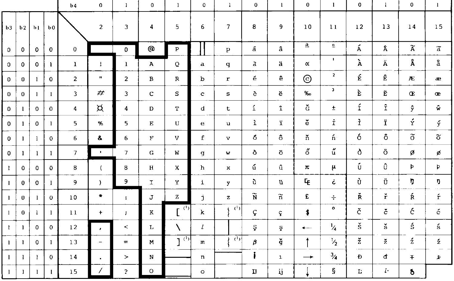

A first quick test: Both typing in manually and reading from a Latin-1 encoded file, everything looks OK in the GUI.
But (there's always a but, isn't it ;) ) ö displays as õ and Ö as Ô on my receivers.
I'll do some more test and go through the entire charset.
If "Latin-1 input" is unchecked, does that mean you expect UTF-8?

Done:
- RDS special characters conversion
Note: RDS special characters conversion could contain errors, if you find any please let me know.
Do you support all characters that I wrote in my string? By Latin-1, you probably mean Win1252, right?
And as Ragnar, I wonder what the semantics of a disabled latin-1 checkbox is.

I put in all the characters that occur both in Latin-1 and RDS charsets. I've tested the 'ü' works, but since I don't have a transmitter (and even if I did I would have to walk pretty far to my car to check the RDS display), I haven't tested the other characters yet...
Without the checkbox, you get the old behavior - they are sent to the transmitter without conversion. So then you need Ragnar's string.
Ok, checking...:
o umlaut = 0xF6 ( http://nl.wikipedia.org/wiki/ISO_8859-1 )
In RDS: 0x97 ( http://www.stereotool.com/images/rds_charset0.png )
My conversion says: 0xF6 -> ??? so it keeps the default = 0xF6 = o tilde.
In my conversion 0xF7 is mapped to 0x97 instead of 0xF6!
Ok I'll use some automated mechanism to check all characters now.
Edit: All should be ok now. Please wait for next build :)
I still do not understand why you do not use my string for conversion - the position of every character gives you the ordinal of it in the RDS encoding.
PostPosted: Mon Dec 31, 2012 3:57 pm
Because there are far more characters! Not just German.
