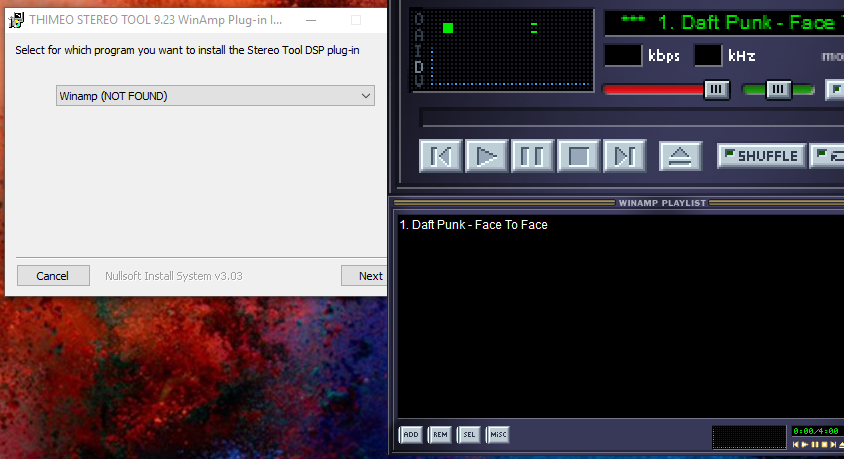

Winamp installer of the latest beta doesn't do anything. It will not detect Winamp and when I choose a different folder that folder will stay empty after the installer is done. Running Windows 10.
Ah found the problem. The plugin will be installed in one folder below the one you select. So I created a folder: c:\plugin and after the installer finish the dll is in c:\
I think I've just fixed this. Can you try if it works now (new version will be uploaded in a few minutes)?
