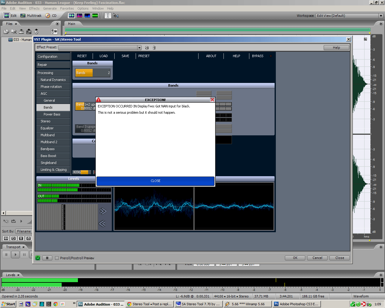

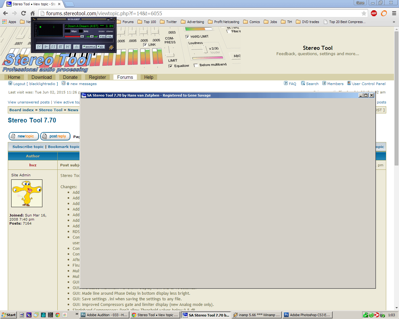

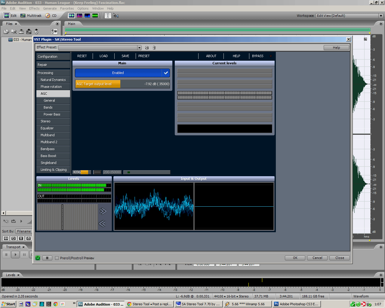

I'm sorry for not reporting this sooner, but I just today discovered an error in the display when I try to run the Winamp DSP and an error when I was previewing the audio and tried to switch on the first AGC.
What information would you like from me to help you troubleshoot these two issues?
File comment: ...Or if it is playing and I try to change the number of bands in the AGC, it gives this error.
File comment: The VST plug-in either maxes out in the meters but gives no sound like a feedback loop when I try to demo the effect...
File comment: Wnamp DSP gives no GUI

PostPosted: Thu Jun 04, 2015 9:31 am
Hans, when you introduced the new analog compressor you said it was peak-based only. Later you added RMS and peak-mode, though as far as I understand, the original mode is now named RMS and peak-mode is a modification thereof. Could you please elaborate a bit on this matter, also what does RMS block size mean in this context? Thanks!
PostPosted: Thu Jun 04, 2015 2:19 pm
Posts: 11490
Please tell me *exactly* what you did to get this behavior, since I don't see it here (tried changing the # bands dozens of times and nothing went wrong). You might need to send me your preset.
