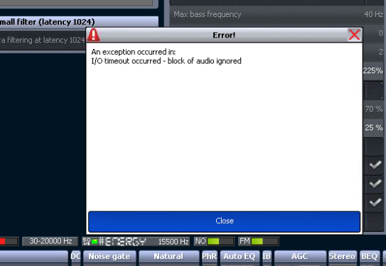

after about 24 hours this message appears, in 9.62 no problem.
ST 9.63
ST 9.63
That message is new, before version 9.63 no warning was shown when this happened. So, most likely, something heavy ran on your pc, causing an audio glitch. Is that possible?
