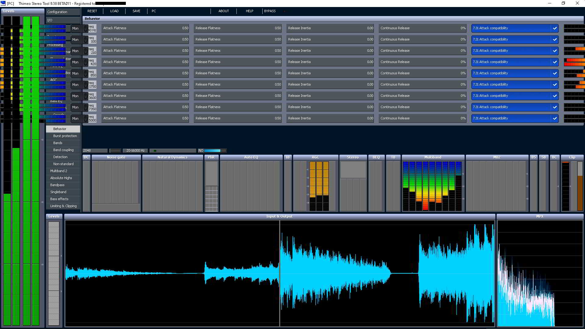

PostPosted: Mon Dec 09, 2019 5:48 pm
New beta (011) posted.
Liking the AGC short burst feature. Thanks! :)
Noticed the 7.31 attack compatibility in SB. Looks like it probably is not saving to local STS configs when disabled as it is always resetting to enabled when changing presets here.
plus the GUI graphical display.
windows 10 x64, version "2004" build 19037.1 (insider build)
