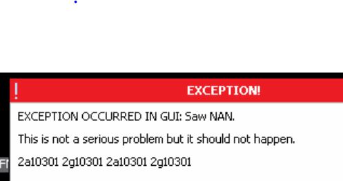

Just saw this come up on a Prod machine running v9.00
I clicked and ignored it, but after 10-15mins it came back with same error and locked up ST GUI totally?
Unfortunately I was not around when it came back the second time and it took the station off air until I restarted the box.

Hi Hans
Rossco
Ow. That's not normal (a NAN usually has no effect, at the worst a short glitch). BUT, I think I don't protect against NAN's anymore in my scope drawing code which might explain the hangup. I'll look into that immediately now.
This is in the input stage. I have never before seen NANs in the input stage...
Questions:
- Which version is this, stand alone, plugin?
- Do you have the 2nd sound card ("SCA input") enabled?
- Are you using tilt correction on the input?
- Are you using resampling on the input?
Edit: NAN protection is still there (implemented differently from before, but it's there). I'm going to insert NAN's myself and see what happens.

Posts: 118
Questions:
Apologies for not supplying more info earlier. I wanted to log it and add to it when I got home....
- This is v9.00 64 Bit Standalone
- Using ASIO drivers for Audinate DANTE DVS for Input, Normal Output, LQLL Output. Using soundcard output for MPX. Have never encountered the error before.
- No Tilt Correction enabled.
- No Resampling on the input.
Regards
Rossco

Questions:
Regards
Rossco
I found and fixed something that might have caused the lockup.
That doesn't explain the NAN itself yet though. I looked up Dante and - according to the first link I found - their format is 32 bit int. Which can't contain NAN's (if their format was floats it could!). What sample rate are you running at? Do you have "Ignore high frequencies" enabled?

Posts: 118
Running 48k (DANTE default). Ignore High Frequencies is enabled.

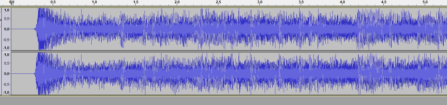

There's still something off with the Dutch Moose preset. The bass we talked about earlier is steady now but overall there are loud volume spikes. I'm talking about perhaps coming from a very quiet section to a very loud one, it's too slow to bring the volume back down or the other way around.
One good example is the very beginning of the song Amorphis - Message in the Amber. The song starts heavy and loud and already one second into the song the preset has a very noticeable and abrupt volume change. It goes from loud to soft, too slowly I think, so it's a very annoying effect.
Attached is a sample audio from a .flac source processed with WatchCat using the latest Dutch Moose preset. Also a picture from Audacity where you can see the spike at the beginning.
