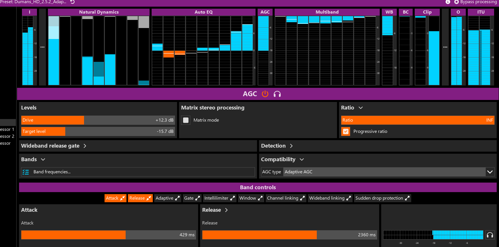

Pavel test - 2024-06-02.stsI have not tried tyour presets yet.
I am using the basic version of ST 10
Does your preset involve features that are not included in the BASIC (no addons) ?
Also, what you think of the sound https://onlineradiobox.com/us/bfm/?cs=us.bfm&played=1
so far? I took some preset that sounded to me ok in terms of Host voices + music. All seems quite balanced
But AGC does not whow activity at all. The input is to the top... drive +8 Do not know :(
thx
I attached my preset, so far all within my basic license (no red warnings). Perhaps you could suggest something. Many thanks in advance.
Hi. Regarding my V 2 presets they are using adaptive settings in mb,wb compressor & agc section used from st 10.21 an onwards and i assume thats why the agc is not working.
Imho the +8 drive in input is too agressive and it might cause distortion during processing.i would recommend 0 gain in st input and about 80% volume on source player and let agc do the rest.
I have listened to the stream you mentioned and it sounds loud and balanced,some audio artifacts though but i can't understand if there is something to do with proceeding or the music source material.
If you wish to listen my older presets there is a thread https://www.forums.stereotool.com/viewt ... 10&t=33695 for older st versions (v9.92 &10.10) I also have https://zeno.fm/radio/ianthos-radio/ stream where i test the latest (currently v2.5 beta in st 10.30)
Hi. Thanks for your reply.
I turned off STEREO and PHASE sections (especially phase) it was creating some weird something that made sound like a bad mp3. I don't know when you took a stab at my stream. I hope you listened BEFORE i made these adjustments. It does sound loud. I am sure bringing the level down is not what needs to be done as it is already -1 db. Must be done by compressors and other modules.
AGC is not moving probably because I did not crank it up somewhere... my version is 10.30 and AGC is at its default settings, but evidently I need to change them to make it pump. But that would make it even louder. I hear that it is quite balanced as is. but my ears do not hear objectively already. :)
AGC starts to show activity on the meters when I move target to -10 instead of +4 (default) and drive remained +8 now I see some movements :) Pavel test - 2024-06-02.sts here is what is now
As i see you use legacy 2 band AGC. If i lower the target level and increase the drive it starts to be more responsive but i thing its obsolete for 10.30
i would recommend to use the adaptive version.here is a screen of my settings in 10.30.Btw adaptive agc freq band is at 2000hz with 6db/oct slope. Of course you should also adapt all the next prosessing st levels (mb,wb,clippers,eq etc)
