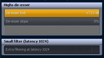

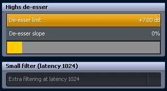

De-esser, can't turn it OFF, only to make it out of thresh, please make on/off button so it can be turned OFF.. completely. Even out of thresh i'm not sure is it 'still' do something.
Internally it's turned off at the highest setting, but that's not visible in the GUI.
the previous highest setting for de-esser was 7.23dB. now the highest setting is 7dB.
manually entering 7.23dB value into the STS file shows the de-esser to be completely off but with the new highest default value adjustable by the slider of 7dB, de-esser is not completely turned off.
File comment: maximum adjustable value is 7dB, leaving the de-esser turned on.
File comment: original value of 7.23dB completely turns off the de-esser.

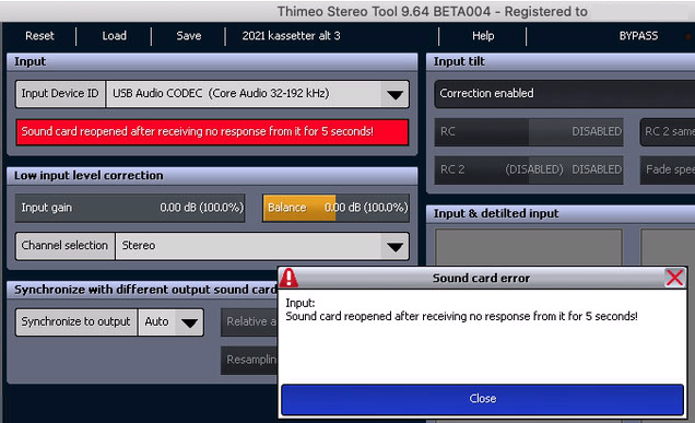

PostPosted: Mon Mar 22, 2021 8:08 pm
Posts: 68
Sorry Hans, stil no go. But atlest now it shows an error. Last version to work was 9.62.
Regards
MrDonT
