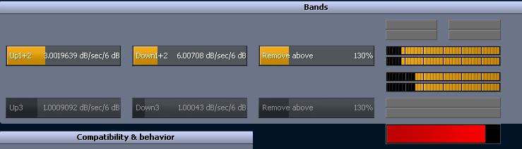

Is there something wrong with this one ? Red bar ? above bands meters ?
Edit: I saw that two separate meters are for Power bass and highs . Just wonder what is the red bar doin there :) outside the area

Ha, as DJ-DOGGY pointed that issue, there's also another. If you are using 2 band AGC, the "Remove remaining peaks above" at the bottom is active for the second band even though it's grayed out.
PostPosted: Tue Feb 11, 2014 11:52 pm
Yes We talking about 2 bands AGC and this affects the whole sound . When you take "Remove above" of the third band even "grayed out" to the 0% all sound is gone , not just that band. With first(bass) band everything is OK.

@PowerSound, @Edgar: I saw something weird in the ASIO code so I fixed it... I have restored the old calculations there so I hope the next build will be ok again.
@DJ_DOGGY: Red bar is AGC gating, but it should be inside the area above it.
PostPosted: Wed Feb 12, 2014 3:04 pm
Yes , i realize this but the problem with "Remove above" is a bug i guess. Third band (even when disabled) should not affect all the sound or first+second bands.
