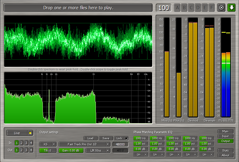

When I choose VLC input, there are mirror-frequencies in the MPX, and the pilot is not perfectly protected anymore. No matter if MPX-clipper is on or off. Good to see when SSB is turned on. Am I doing something wrong? O_o
