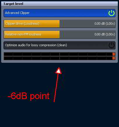

i have an idea that might be good.
i often find that any content that is clipped greater than -6dB by the advanced clipper has audible distortion (even with ABDP enabled).
in turn, i try to keep the content clipped by the advanced clipper to no greater than -6dB, but sometimes, there is content that will be clipped greater than -6dB.
how about a re-settable static peak hold indicator for the advanced clipper ?
in this manner, i can operate ST with 100% display refresh in a minimized state during operation and observe it later for any peak holds greater than -6dB and then i can make adjustments accordingly to keep the clipper at -6dB or less.
thanks.
thanks.
Good idea, I'll pass it along to the people working on the new GUI.

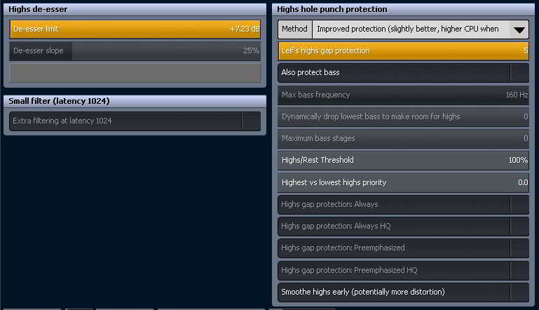

How about a post-preemphasis limiter for those who don't want to clip at all?
PostPosted: Wed Mar 04, 2020 10:48 pm
i believe you can achieve what your looking for by configuring these parameters to your liking.
edit: strike that, it only works if advanced clipper is enabled.
perhaps a change could be made to have it enabled if not using advanced clipper ?
i understand what you are desiring to achieve.

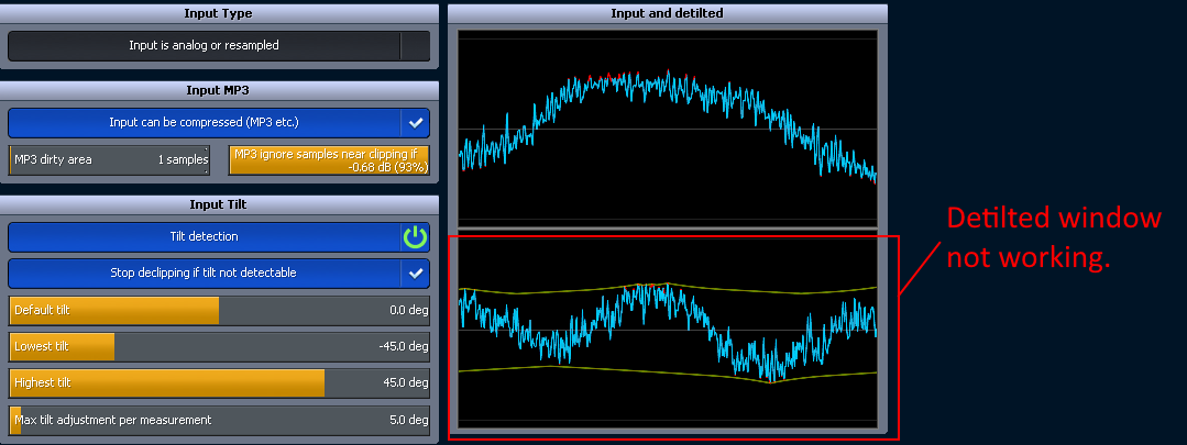

Minor display issue in declipper. Detilted window not working/updating. Image attached. Tested in Winamp DSP version.
