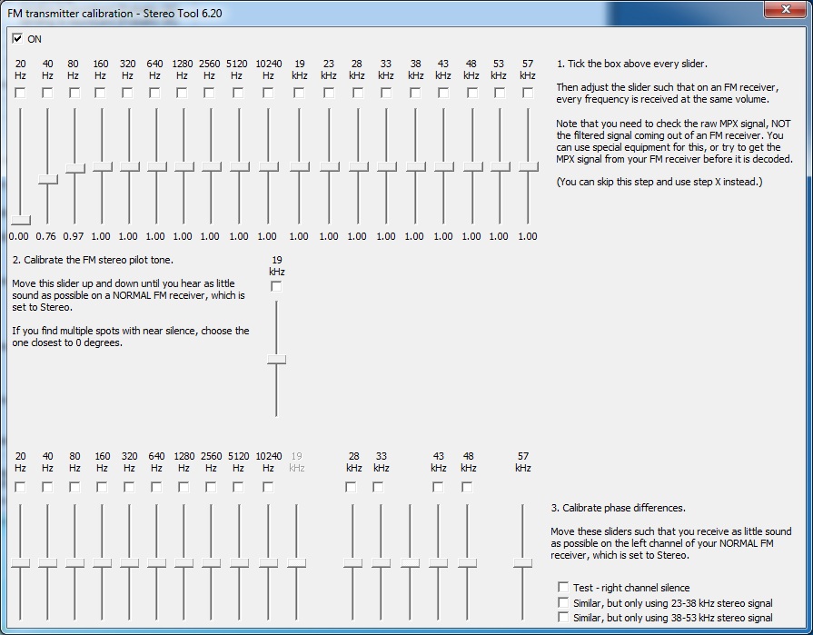

Hi guys,
I have not any time in this moment but i test quickly to correct tilt, and mesure with pira75.
it is the bass frequency that generated the peak over 75khz, i calibrated fm transmitter quickly and it's ok now !
Thanks a lot, good job Hanz, ST is very good product! A new french radio use ST at the end of october !
