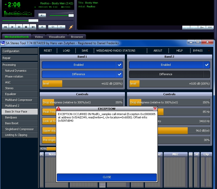

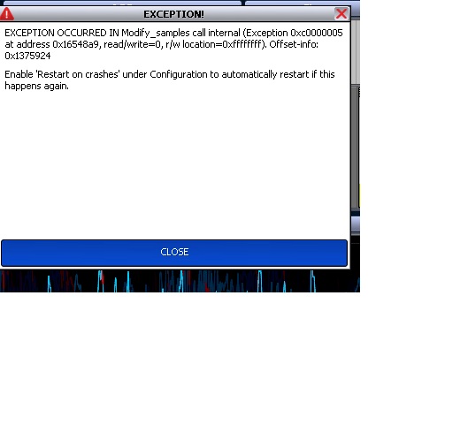

 Post subject: Re: Stereo Tool 7.73
PostPosted: Fri Oct 30, 2015 4:14 pm
Posts: 140
For now just technical report, not fully tested it
windows 10 standalone
beta 18 BIYF works
beta 19 BIYF st crashes

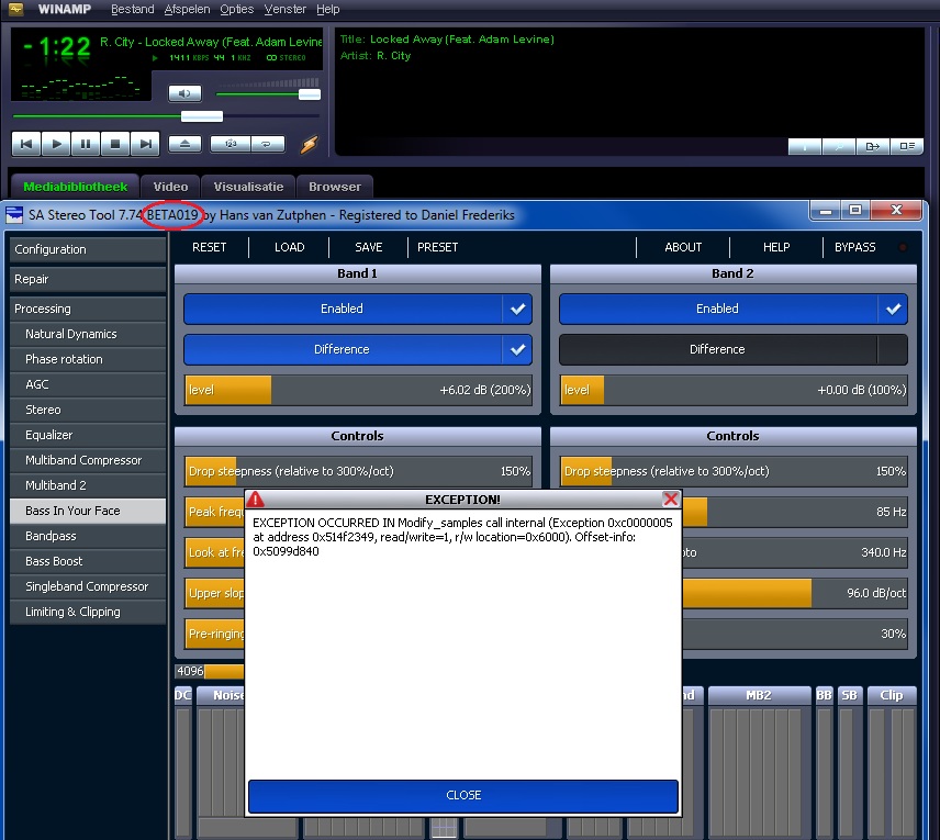

PostPosted: Fri Oct 30, 2015 4:17 pm
Posts: 136
Stereo Tool Beta019 Crasht (weird sound) when select Difference in BIYF
Edit: Stereo Tool Dsp
Windows 7
PostPosted: Fri Oct 30, 2015 6:02 pm
Rationale for putting it after MB2:
- Amount of bass added is always roughly the same, except when there already is a lot of deep bass. It seems to make it more constant. So you can always reduce the first 2 MB bands a bit to compensate.
- More importantly, it sometimes generates rumble which would be amplified by putting it before the MB's.
Crash:
- That's this thing again that doesn't show up on newer Intel chips (i3/5/7 3000/4000 series), but it does on older ones. I think I've fixed it, new build is running.
I'm off to the Oktoberfest, will post it afterwards.

It has a new much faster chipset that doesn't consider this to be an error. I can *make* it see it, but then it will run at a 10% slower speed on these CPU's.
PostPosted: Sat Oct 31, 2015 9:09 am
Posts: 136
Same problem as Beta019.
I use Beta020 but ST shows Beta019 (look picture)
