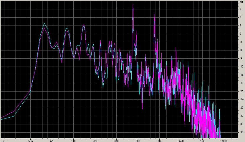

Just thinking aloud here...
Basically, as long as all the sounds at all different frequencies stay within the same volume range, everything is fine.
Now if a single (or a few, in case of voices) frequency stands out - be it bass, a loud voice, whatever - we get in trouble.
For example, a loud voice in that Celine Dion track looks like this:
Here you can see why in this case the bass is actually helping to keep the volume constant!

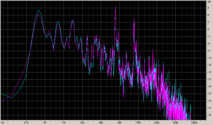

Equalizing it according to ITU-1770 makes things even (a lot) worse:
The bass is lower, and the voice peak is higher, which makes things a lot worse.

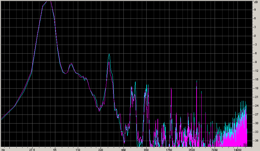

Another troubling sound is Beyonce - Video Phone:
Which gets better when using ITU-1770 processing, but still contains an insane amount of bass.
