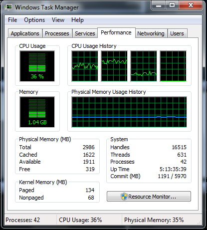

Here are the results from the i3.
Same settings as the previous shot but running on all processors.
Windows 7 32x, 4 Gig RAM, i3 3.3 GHz, M-Audio 192 Card (Modified I/O caps).
The i7 3770 might be a better choice?
Thanks,
Clipper
Why? Are you still having buffer issues?
Based on the CPU loads I would say it's ok... (Of course an i7 will be faster, but if latency is not an issue this should be good).

Hans,
No, but as my CPU usage was 38-39% with the Q9650 and you though:
CPU load is close to the edge
I thought that this one at 36% may be the same.
I ended up getting the i7 3770 and we'll put it in the machine tomorrow and that should make a good machine for it to run on without any problems.
