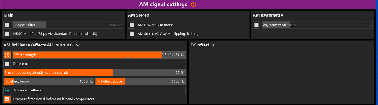

where is brilliance in beta17? I can't find it under "highs" tab anymore.
post amplifier is just when you are comparing different presets against each other and wants everything to be on the same level for easier comparison.
Hi gjbbgu,
It looks like the brilliance setting has moved to under the AM signal settings screen, see screenshot below.
But this now only seems to effect the audio when AM is turned on.
I just use HD Output as do not have the FM licence in StereoTool, and
whereas the earlier version: BETA1042-008 seemed to have an effect on the audio
for HD Output, now it is under the AM signal settings it only seems to work when
the main AM signal setting button is turned on, and the brilliance button it on too.
But doing this, for me, makes my HD Output turn into AM audio which I dont want.
The text after the AM Brilliance states, (affects ALL outputs), but this does not seem
to do anything for the HD Output if I turn off the main AM signal setting button.
Not sure if I am doing something wrong?
Does anyone else know how to get the Brilliance to work with HD Output correctly?
Thanks in advance

You need to uncheck all the boxes in the AM section except for the Brilliance setting to get it without the lowpass mono AM sound.
PostPosted: Sat Oct 12, 2024 7:16 pm
Joined: Fri Oct 11, 2019 10:11 pm
Posts: 20
Location: England, UK
Hi MrKlorox,
Thanks for the information, much appreciated.
Indeed, it works now after following you advice.
Thank you :)

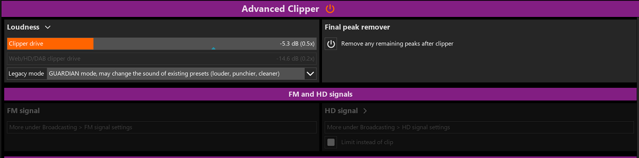

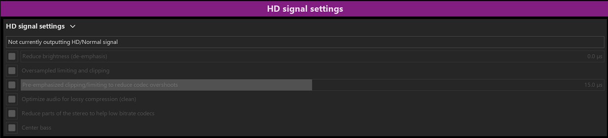

When I turn on "AM Signal Settings" and "AM Brilliance" I lose the "Web/HD/DAB clipper drive" setting in "Advanced Clipper" and the "Oversampled limiting and clipping" option
Strange! As in they're missing, or they grey out, or what?
They're visible and functioning here with AM Signal Settings and only AM Brilliance enabled.
edit: Ah I see your edit now. Strange indeed.
edit2: Can you show your I/O page?
edit3: my Lowpass Filter Signal before multiband compressors is greyed out however.
