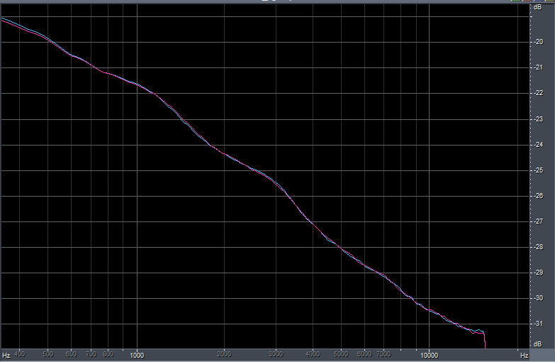

Hans, can you test Clipper only from this preset - that graph?
Sure, here's the output (left and right channel are the two colors here):

O, between about 3000 and 4400 Hz, my new build adds about 0.1 dB (1 pixel in the graph) of loudness compared to the version that you're currently testing. The image here was with that new build.
PostPosted: Fri Mar 19, 2021 10:17 pm
Idk what i am looking at now. This is different then erlier pics.
Those were for only the clipper. This new image is for a complete preset.

ok is that cooledit?
Audition, but that's basically the same thing.
:o Mind blown. I just checked out this retro DAW and man, I wish I had found Cool Edit 20 years ago. I'm practically just now developing a taste for audio and this could have put me on track to learning so much earlier. Nice to see that's what the screenshots of analysis stuff used in the documentation are from as well. I had always assumed it was some internal tool.
