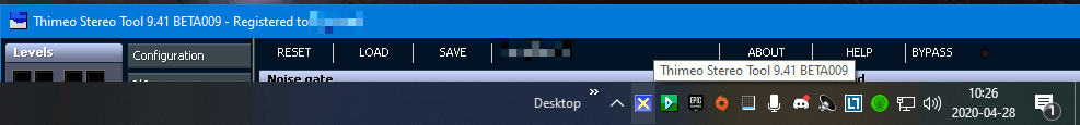

I was going to post about an issue that was in beta 9 and earlier, but you seemed to have fixed it in this version 11. I'll still post what it was in case it pops back up.
Basically, right clicking the tray icon a second time to disable the bypass works, but the icon didn't change back to normal.
