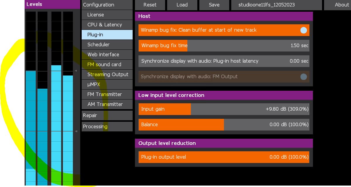

Thanks, the numbers there are so little - I didn't see them at first :D Will try this!
Edit: Now the input gain is set to +9.8 db.

If it's more than -6db sometimes - is this a problem then or does the preset its work anyways?
 Post subject: Re: StudioOne HD / FM
PostPosted: Fri May 19, 2023 7:07 pm
Posts: 242
If it's more than -6db sometimes - is this a problem then?
No. Just want the average to be around there.
