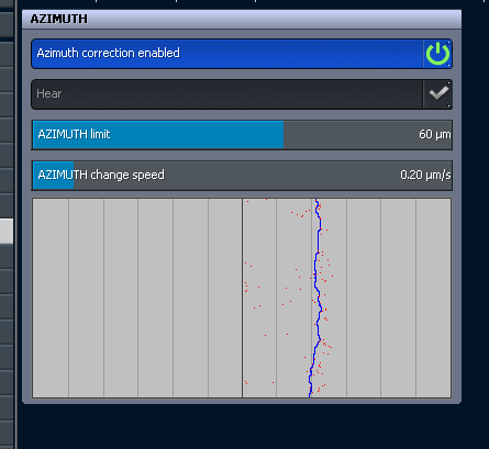

CONFIRMED: raw track ripped from "Ultimate Prince" disc 1 2006 Warner Bros Records sends the azimuth corrector off the deep end, creating a muffled and out of phase mono signal.
I've attached a file showing how far the azimuth is moving the line, and that I am using the default settings.
