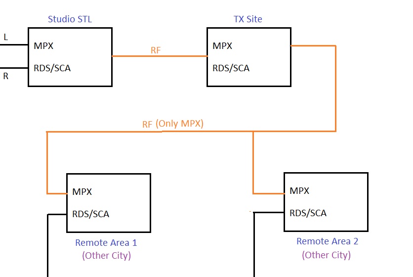

 Post subject: Re: Audio Routing
PostPosted: Tue Aug 28, 2018 4:34 am
Posts: 85
I am strugling to understed how is that usefull (?)
It would be useful to insert an MPX signal (Without RDS) into the MPX input of the STL and the separated RDS signal into another RDS / SCA input of the STL. On the TX site, the MPX signal can be distributed to other sites without the RDS information. In this way, the local RDS information remains in the original place and the only thing that is massified is the MPX signal.
PostPosted: Wed Aug 29, 2018 12:10 am
Posts: 4238
Ok that's fine, but what i know L/R is usually distributed nowdays. Wich is also more logical and easier to use.
PostPosted: Thu Aug 30, 2018 9:28 pm
Posts: 85
Yes, but from the ST output, both channels carry the same information. It could be much more useful to distribute the signals to send them in a different channel.
PostPosted: Thu Aug 30, 2018 10:32 pm
Posts: 4238
Don't get me wrong, if Hans wants to add that routing it's fine with me.
However, whole inustry is based on clean MPX signal, wich nowdays, as we can see, makes some very good benefits. Clippers and composite clippers, and embedded sca's is very good reason to use MPX output from ST, or other processor with similar possibilities. The way you want to route things, this all stuff is not possible.
I would rather look at that transmitter, and find/make clean MPX input. That's just me.
