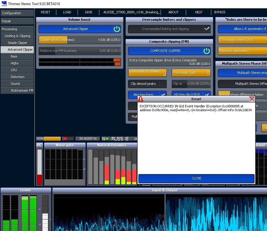

PostPosted: Mon Jul 23, 2018 1:23 pm
GUI Exception... see attached.
PostPosted: Mon Jul 23, 2018 2:56 pm
Posts: 11520
@Paul: What did you do when this happened? It's really really had to find the cause without any context.
