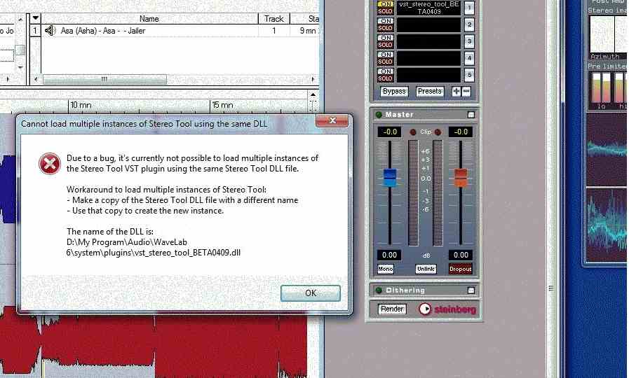

Hallo,
I use your excellent tool as VST-Plugin in Wavelab.
But since your beta 5 release when I would like to render my audio WaveLab crash with following message:
Due to a bug, it’s currently not possible to load multiple instances of the stereo Tool VST plugin using the same Stereo Tool DLL file.
Workaround:
Make a copy of the Stereo Tool DLL with a different name
Use that copy to create the new instance
But in my case I use only one instance of the Stereo Tool VST plugin.
Regards
Claude
File comment: printscreen

I added this notification because loading 2 instances can cause crashes. Of course it wasn't my intention to have this message getting displayed if you load only one.
I'm downloading a trial version of WaveLab now to see if I can find out why you get this message.

It doesn't seem to happen here (I downloaded WaveLab 5, which version are you using?). I did find another bug though: If one Stereo Tool instance is loaded and an attempt is made to load another, it causes things to crash. I'll have a fix ready for that in a moment - but it won't remove the problem with the popup itself.
Could you please tell me:
- Which version of WaveLab you are using
- What you do exactly (what I did: Just click on the panel for plugin 1, select VST -> vst_stereo_tool.dll).
If I do this again for Plugin 2 I do get this message (as expected).

For information: I use WaveLab 6 and windows 7
Exactly what's happen is that I load stereotool in plugin 1. When I do my audio montage everything is ok. I can adjust my parameters in stereotool and listen the processed audio.
But when I have finished and I press the RENDER boutton for processing my whole montage with stereotool to a new file then it crashed.

I just tried what you described and I'm getting the same popup now.
Will look into this.
Before I added this message, have you ever had strange crashes in WaveLab after rendering? I added this message for a reason - basically when this situation occurs something goes really wrong inside Stereo Tool...
