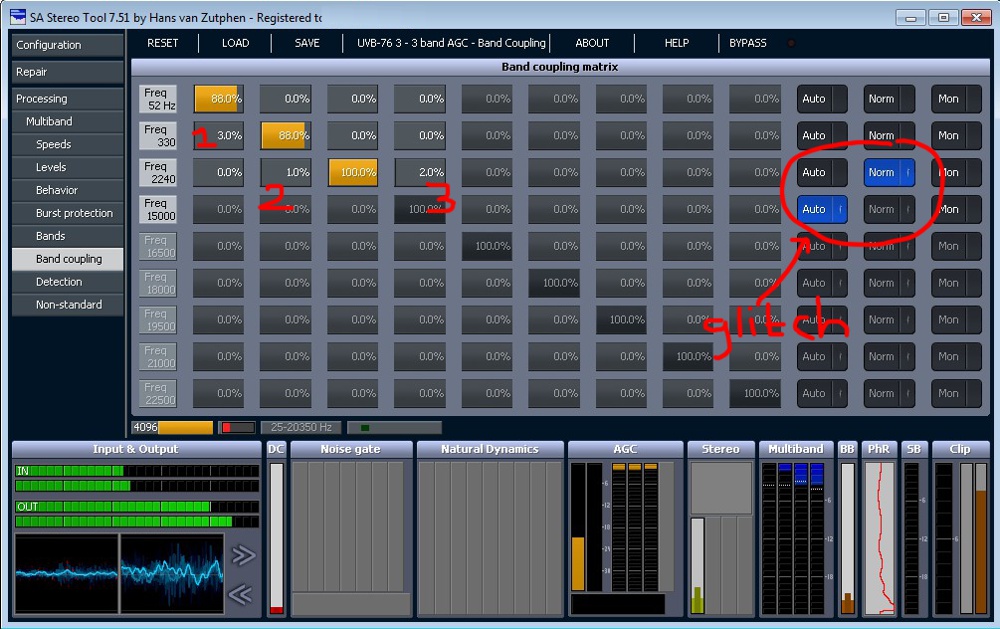

Edit 3: Added screenshot. Is my interpretation correct if I say that:
#1: Band 1 is coupled 3% to band 2? Or is it the other way around: Band 2 coupled 3% to 1?
#2 and #3: Band 3 coupled 1% to band 2 and 2% to band 4
I would also like to know what extactly happens/ is adjusted when I lower the coupling of its own band (the 88% of band 1 and 2 is relative to what?). Bands 1 and 2 are reacting much faster.
p.s. notice the visual glitch.

You are using it wrong. You want all that slides at 100% always, but other band (more then 0%) to follow choosen band.
hmm.. hard to explain :D
