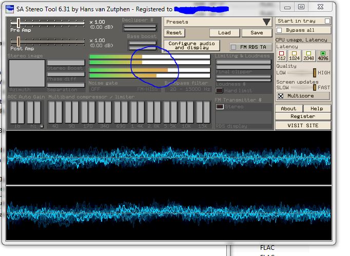

But the bars in Sterotool also show the increase in the peaks. Here is an example. Only phase rotation, no loudness. Song: Bon Jovi, Story of My Life, very compressed (with replay gain, hence the low overall volume; settings are: 240, 1920, 4.00, 95.0%). You can clearly see the difference (I think I can hear it too, thought not very sure, I believe it is in the lows, like more punchy sound, which I like a lot).
https://lh5.googleusercontent.com/-covu ... xample.JPG

Stereo Tool's output bars show peak level, and that's indeed higher. But that's all - the sound did not (or just barely) change - and definitely not in level.
