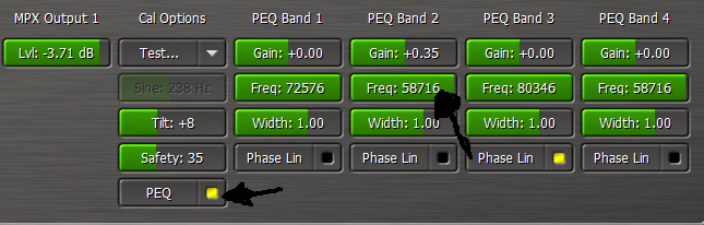

Hi hans,
it's possible in the next build to have the quick sweep (I/O - FM OUTPUT - TEST TONE)as in BAO, and relative PEQ?
PostPosted: Thu Nov 08, 2018 9:58 pm
Posts: 11520
Hi hans,
There is a sweep that goes up and down. It's not exactly the same thing but it will quickly show you if there's any frequency issue.
What do you mean by relative PEQ?

Posts: 130
Hi hans,
thanks for the answer, yes, naturally I already tried with the sweep in ST, but being slow does not allow you to have instantaneously the frequency response from 20 to 60,000, while with the quick sweep see in real time the frequency response if it is flat (roll-off) or if it needs to be modified via a parametric eq (PEQ).
in this video, leif explains it much better than me.
https://www.youtube.com/watch?v=pHhqOqQKxzw&t=69s
P.s. SMSL Sanskrit it is an excellent alternative to the classic sound cards, naturally in some particular uses, eg. VAC input (100 euro)

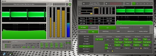

PostPosted: Thu Nov 08, 2018 11:02 pm
Posts: 130
Hi hans,
thanks for the answer, yes, naturally I already tried with the sweep in ST, but being slow does not allow you to have instantaneously the frequency response from 20 to 60,000, while with the quick sweep see in real time the frequency response if it is flat (ro-off) or if it needs to be modified via a parametric eq (PQE).
I forgot, PEQ, parametric eq
PostPosted: Fri Nov 09, 2018 12:33 am
Posts: 11520
Ah, there IS something like this in Stereo Tool but I made it many years ago and it's not a parametric eq. But, it can be used to make even completely nonlinear transmitters flat (I tried with a $15 battery powered transmitter). You can find it under the FM sound card settings in a subpage below that. But, there's no way to get it perfect with only a sweep, you basically need to play each frequency separately and measure and tweak not only the amplitude, but also the phase. (Having said that, you shouldn't need it if you have a somewhat decent sound card and transmitter - tilt correction + high frrequency correction is normally sufficient).
PostPosted: Fri Nov 09, 2018 1:03 am
But.. peq is better and quick sweep is easier to see.
PostPosted: Fri Nov 09, 2018 7:19 am
Posts: 130
sure hans, tilt and calibration were the first things I did.
I agree with bojcha.
