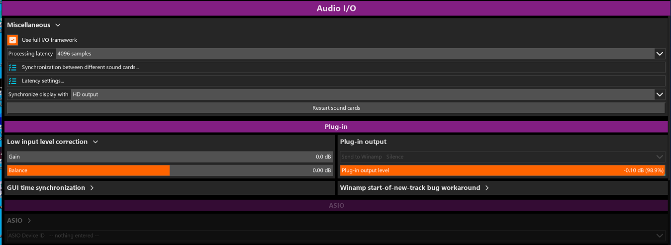

When I turn on "AM Signal Settings" and "AM Brilliance" I lose the "Web/HD/DAB clipper drive" setting in "Advanced Clipper" and the "Oversampled limiting and clipping" option
Strange! As in they're missing, or they grey out, or what?
They're visible and functioning here with AM Signal Settings and only AM Brilliance enabled.
edit: Ah I see your edit now. Strange indeed.
edit2: Can you show your I/O page?
edit3: my Lowpass Filter Signal before multiband compressors is greyed out however.
Yes, they are gray as inactive
below is the "Audio I/O"

Ah, so you're using a plugin and you've already tried enabling the full i/o framework. Hmm. Yep, I'm getting this in the VST2x64 too. I'm even able to enable "Lowpass Filter Signal before multiband compressors" like your image -- unlike in my standalone instances.
Pointing Hans this way.

I use VST2x32, I tried to turn on and off the full i/o framework, the behavior is exactly the same

@MrKlorox Thanks for helping,
"Web/HD/DАB slider" I need for correction in most cases for lowering and sometimes raising the level
Used VST-host in RadioBOSS (does not allow entering from the keyboard (I use a notepad and it is good for me, I write down the last changes in the preset before saving it))
yes, I tried different options of "Plugin Output" in the sub-item "Send to Winamp" but nothing changes

No, the goal is to set a different clipper drive than for FM. Because you typically don't want (a lot of) clipping on HD out.
PostPosted: Mon Oct 14, 2024 9:59 am
Posts: 11456
where is brilliance in beta17? I can't find it under "highs" tab anymore.
Oh! I moved AM Brilliance to AM settings, but there should also be a normal Brilliance setting which is somehow missing. I'll check why.
Edit: I see all the other posts; the "affects all outputs" is there as a warning: If you just want to add/boost the highs in the AM frequency range that will affect HD out as well if you're using both, because we need to do it early in the chain, before the AM and HD outputs are split. Similarly, the "lowpass before MB" would kill all the highs on the HD output, so we don't do that if both AM and HD are enabled. Anyway, I will check why the other "Brilliance" (without AM) menu is gone.
