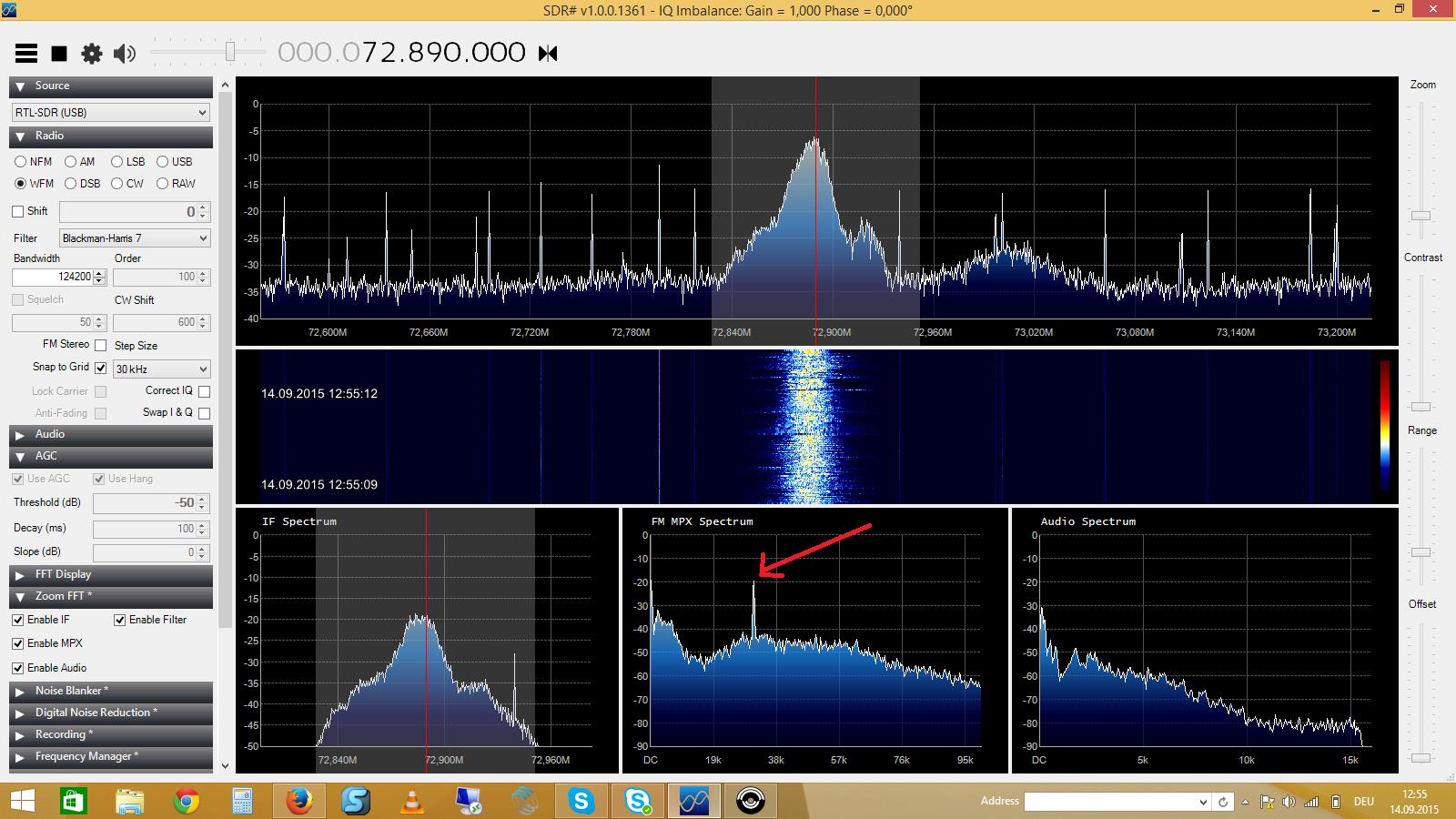

Instead of having a Stereo Pilot sitting at 19 kHz and having a suppressed carrier at 38 kHz, Polar uses a Pilot at 31,25 kHz, but reduced by 14 dB

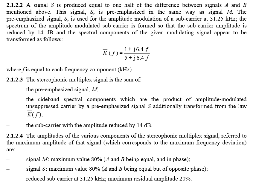

This is the way it should be implemented according to ITU:
See attached file.

About 2.1.2.4: that appears to forbid using composite clipping??

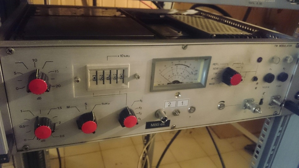

I don't have a polar-capable SDR program ready but a original OIRT transmitter and the corresponding tuner, so I could test it.
As for clipping, I can't tell. Here is the full spec:
https://www.utdallas.edu/~dlm/3350%20co ... !PDF-E.pdf
