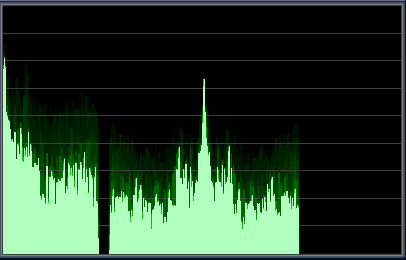

So this should be ok?
PostPosted: Fri Jan 22, 2016 6:09 pm
Posts: 11213
Edit: No. There is still that K function. Not sure what they do there. Anyway, it would be worth a test to see if you get a stereo signal with this now. It looks like the stereo signal needs to be reduced a lot in amplitude though, so you probably will have FAR too much stereo.
Edit: I really don't understand that K function. And what is j? Or are they complex numbers (j is usually called i then, but it's sometimes called j). Do you have more info about this? I'll send you a beta with this - but without K function - in a few minutes.
