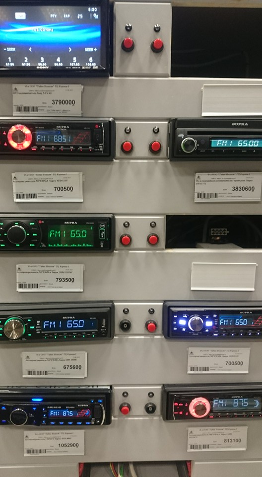

No, it has nothing to do with television. It's FM Modulation for Stereo still used widely in the lower FM part (64-73 MHz) in Belarus, Russia and other CIS countries.
Instead of having a Stereo Pilot sitting at 19 kHz and having a suppressed carrier at 38 kHz, Polar uses a Pilot at 31,25 kHz, but reduced by 14 dB
And also Radios are available.

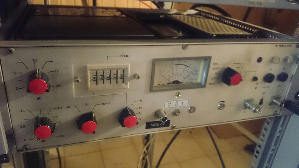

I don't have a polar-capable SDR program ready but a original OIRT transmitter and the corresponding tuner, so I could test it.
As for clipping, I can't tell. Here is the full spec:
https://www.utdallas.edu/~dlm/3350%20co ... !PDF-E.pdf
